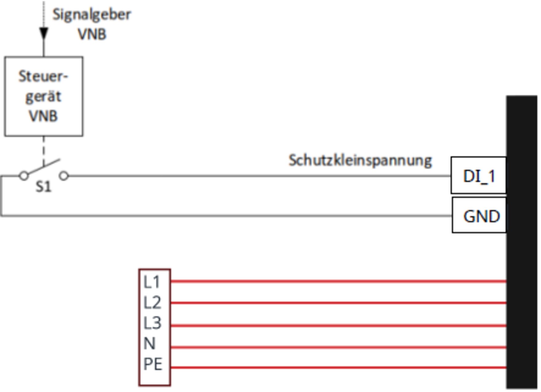

    Digital input
    link_horizontalLink copied
    The Fronius Wattpilot Flex is equipped with a digital input (DI_1).
    This input in the grid lead limits the charging current. The following use cases are possible:
    • Charging unlocking via a keylock switch
    • Connecting the Wattpilot Flex to a ripple control receiver (request from the grid operator)
    • Using the Wattpilot Flex as a controllable load in accordance with Section 14a EnWG (Energy Industry Act)
    NOTE!
    Only permanently installed switching devices of overvoltage category 3 (in accordance with EN IEC 60664-1) may be used.
    Before installation, check that the components used satisfy the corresponding insulation requirements.
    Digital input settings are configured in the Solar.wattpilot app (Settings > Digital input) and can be protected with the technician password (Settings > Password > Protect digital input).
