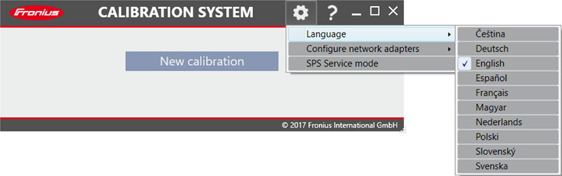

    Setting the language, system information
    After the calibration software has been installed, the language can be set for the user interface:
    The system switches to the chosen language when the program is restarted.
    NOTE!
    Only the user interface of the calibration software is displayed in the chosen language. The language for the calibration report must be set separately!
    NOTE!

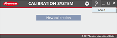

    Retrieving system information
    Clicking on the ? displays the following system information:
    • Software version of the calibration software installed
    • Software version of the Beckhoff elements installed in the calibration system
