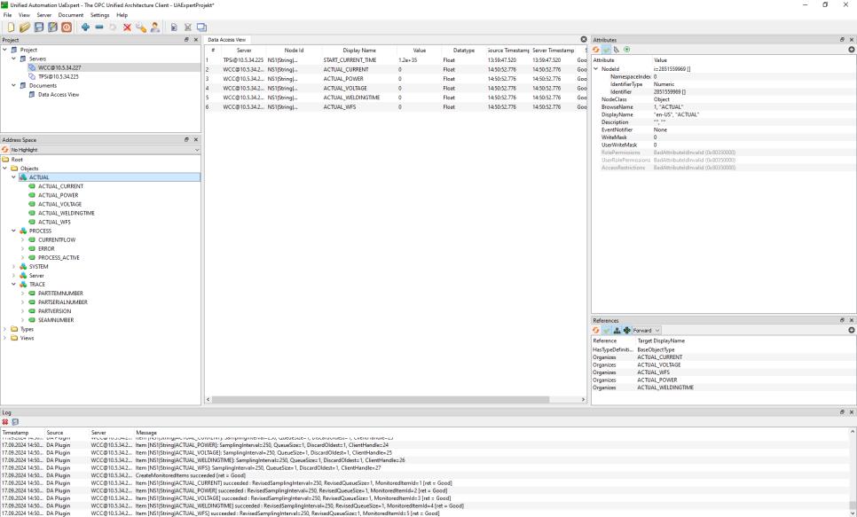

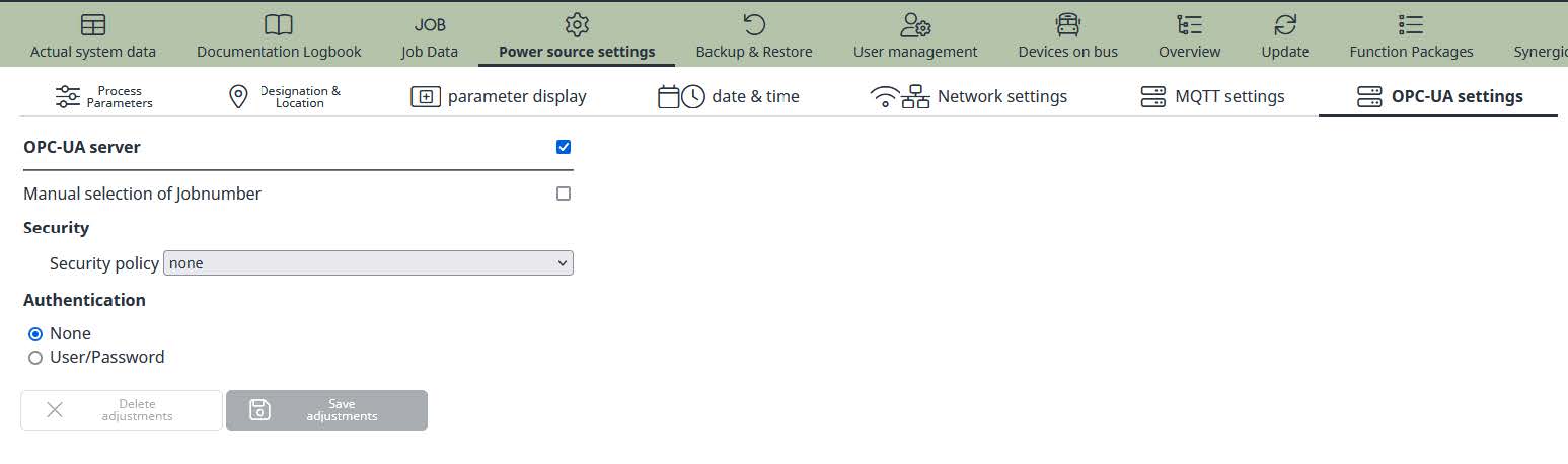

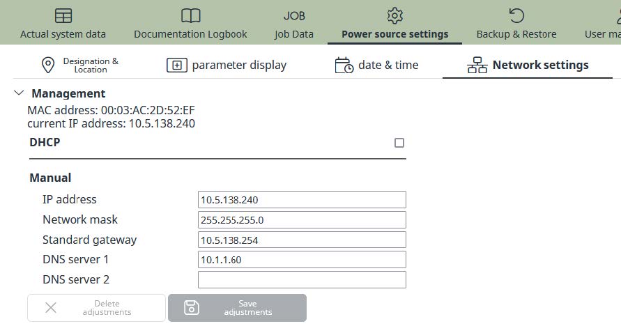

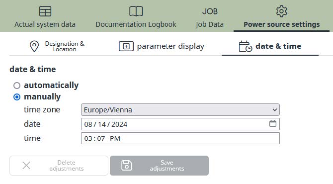

    • Setup and Installation
      • Enable/Disable OPC UA Server
      • Security Settings
      • Sampling Rate
      • Network Settings
      • Time Server Settings (NTP)
    • Examples and Best Practice
      • Getting started with UaExpert Client

    The configuration page for OPC UA setup is located in the SmartManager (welding system website) under the topic “Power Source Settings”.
    NOTE: The settings for OPC UA are not affected on backup and restore of FRONIUS welding machines.
    OPC UA: power source settings - OPC UA settings
    OPC UA settings:
    • Enable/Disable: Enable or disable OPC UA server
    Security:
    • Security policy: Select security policy
    • Server certificate: Upload server certificate
    • Server private key: Upload server private key
    Authentication:
    • None: Do not use username/password for authentication
    • Username: Username for authentication
    • Password: Password for authentication

    Network Settings
    To ensure proper function of OPC UA communication it is necessary to setup the TCP/IP parameters according to your network policy. It is recommended to use a static IP address or DHCP reservation.
    OPC UA: network settings
    For all documentation purposes within the FRONIUS welding data product family it is recommended to synchronize date and time with a local or global time server.
    MQTT: date & time
    The easiest way to start with OPC UA on FRONIUS welding machines is to use UaExpert Client by Unified Automation GmbH.
    The following instruction will guide you through the first steps by using Microsoft Windows® and default settings in anonymous mode.
    STEP 1
    • Register and download UaExpert Client from https://www.unifiedautomation.com

    • Connect your FRONIUS welding machine to your network
    • Enable OPC UA on your FRONIUS welding machine by using the SmartManager
    • Select encryption “none”

    • Start the UaExpert Client
    • Select “SERVER” and add a new connection
    • Double click on “Add Server” and enter the IP address or host name of the FRONIUS welding machine
    • Open the TreeView and select “Discovered Device” and press “OK”
    STEP 4
    • Select your server and connect the address space will update automatically all objects and nodes
    • Per drag and drop you can select the nodes you want to view or write
