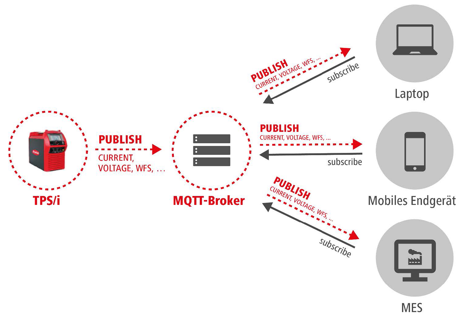

    Schematic Overview
    The following schematic overview shows how MQTT works.
    MQTT: publish <-> subscribe

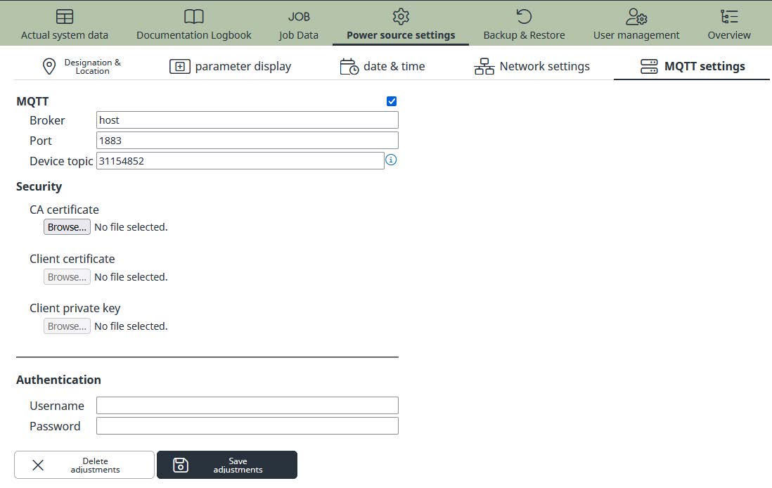

    The configuration page for MQTT setup is located in the SmartManager (welding system website) under the topic “Power Source Settings”.
    NOTE: The settings for MQTT are not affected on backup and restore of FRONIUS welding machines.
    MQTT: power source settings - MQTT settings
    MQTT settings:
    • Enable/Disable: Enable or disable MQTT communication
    • Broker: Host name or IP address of MQTT broker
    • Port: Port used by MQTT broker
    • Device topic: Device name used in the root topic
    Security:
    • CA certificate: CA root certificate
    • Client certificate: Client certificate
    • Client private key: Client private key
    Authentication:
    • Username: Username for authentication
    • Password: Password for authentication

    Enable/Disable MQTT Communications
    By using the enable/disable flag of the checkbox the MQTT communication for the welding machine can be enable or disable in general.
    Disable the communication will also inform the broker to set the online status of the device to “false”.
    1. Setup and Installation
    Broker Settings
    To connect to the designated MQTT broker in your network you have to fill in the host name or IP address and the used TCP port. Please check in advance the network settings of the welding machine and the firewall configuration (in and out) of your network infrastructure to ensure proper function.
    MQTT uses by default the TCP port 1883. If using SSL/TLS it is recommended to use port 8883 as defined in the standard. Any other port can be used if needed.
    Device Topic (Name)
    The device topics is part of the root topic and identifies the message for any subscriber. If this field is blank, the serial number of welding machine will be used by default.
    The following characters are allowed: “A-Z”, “a-z”, “0-9”, “_”
    In addition the use of “/” is possible to extend the root topic.
    Security Settings
    Without any authentication and SSL/TLS certificated MQTT will work in anonymous mode. By using username and password the access on the published topics can be restricted. To encrypt the communication between broker and client you can use certificates and private keys.
    It is not recommended to use authentication by username and password without encryption.

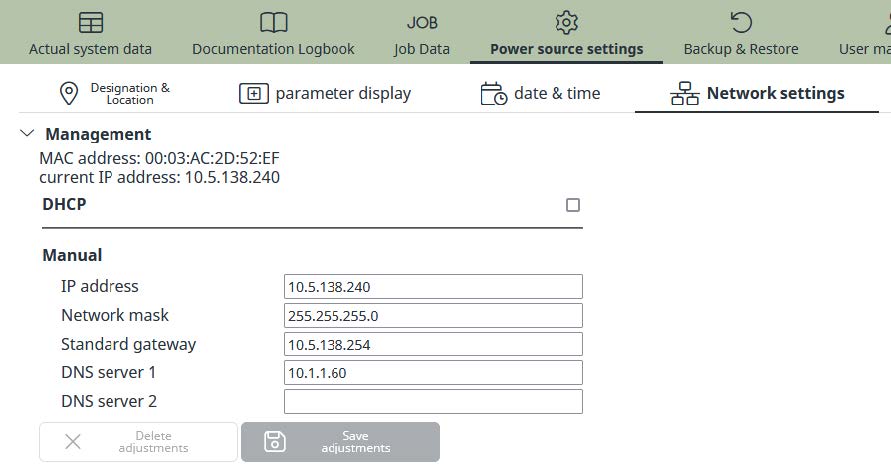

    Network Settings
    To ensure proper function of MQTT communication it is necessary to setup the TCP/IP parameters according to your network policy. When using a host name instead of the IP address for the MQTT broker a DNS server is required.
    MQTT: network settings

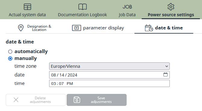

    Time Server Settings (NTP)
    For all documentation purposes within the FRONIUS welding data product family it is recommended to synchronize date and time with a local or global time server.
    MQTT: date & time
