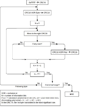

    CRC Calculation for Modbus RTU
    link_horizontalLink copied
    Each Modbus RTU message is equipped with a checksum (CRC, Cyclic Redundancy Check) in order to be able to identify transmission errors. The size of the checksum is 2 bytes. It is calculated by the sending device and attached to the message to be sent. For its part, the receiver calculates the checksum from all bytes of the received message (without CRC) and compares this with the received checksum. If these two checksums are different, then an error has occurred.
    The calculation of the checksum starts with setting all bits of a 16 bit register (CRC register) to 1 (0xFFFF). All bytes of the message are then individually processed with the CRC register. Only the data bytes of one message are used for the calculation. Start, stop, and parity bits are not considered.
    During the calculation of the CRC, each byte is XOR-linked with the CRC register. The result is then moved in the direction of the least significant bit (LSB) and the most significant bit (MSB) is set to 0. The LSB is considered. If the LSB was previously 1, then the CRC register is XOR-linked with a fixed assigned value. If the LSB was 0, then nothing needs to be done.
    This process is repeated until the CRC register has been moved eight times. After the last (eighth) movement, the next byte is taken and XOR-linked to the current CRC register. The write process then starts from the beginning; it is again moved eight times. After dealing with all bytes of the message, the value of the CRC register is the checksum.
    Calculation algorithm of the CRC16
    1. The Modbus Protocol
    Calculating CRC Checksum
    1Initialize a 16 bit register (2 bytes) with 0xFFFF. This register is referred to as the CRC16 register.
    2XOR-link the first byte of the message with the less significant byte of the CRC16 register. The result is saved in the CRC16 register.
    3Move the CRC16 register 1 bit to the right (in the direction of the LSB), fill MSB with 0. Look at LSB.
    4Check LSB value
    - If the LSB was 0: Go to step 3 (move again).
    - If the LSB was 1: XOR-link the CRC16 register with the CRC polynomial 0xA001 (1010 0000 0000 0001).
    5Repeat steps 3 and 4 until eight movement operations have been carried out. When these have been carried out, a complete byte of the message will have been processed.
    6Repeat steps 3 to 5 for the next byte of the message. Repeat everything until all bytes of the message have been processed.
    7After the last byte, the CRC16 register contains the checksum.
    8When the checksum is added to the message to be sent, then the two byes must be inverted as described below.

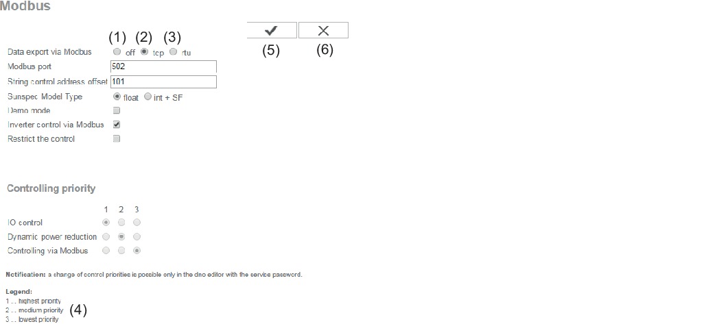

    Opening the Modbus Settings
    1Install Fronius Datamanager
    => see the Fronius Datamanager operating instructions.
    2Open Internet browser
    3Enter the following in the address field of the Internet browser:
    • the IP address of the Fronius Datamanager (can be accessed via System Information)
    • or host name and domain name of the Fronius Datamanager.
    The web interface's start page is displayed.
    4Select the "Settings" section (1).
    5Open the "Modbus" section (2).
    NOTE!
    In the case of Fronius Datamanager 2.
    0, the "Data output via Modbus" is set to rtu in the factory.
    The rtu option is not available for the Datamanager 1.
    1. Modbus Settings
    Open the Modbus settings
    1Open the web interface of the inverter
    2Select the "Communication" section (1)
    3Open the "Modbus" menu item (2)
    1. Modbus Settings
    Data Output via Modbus
    Activation of the Modbus service and selection of the transmission protocol.
    If the Modbus service is activated, additional entry fields are available.
    The Modbus rtu transmission protocol is only available for Fronius Datamanager 2.0.
    Note! If there is a Modbus energy meter (e.g., Fronius Smart Meter) configured under Settings/Meter on the system, it will not be possible to use the "rtu" setting. In this case, data output via Modbus will be deactivated automatically upon selection of "rtu." This change will only be visible once the Datamanager website has been reloaded.
    Any energy meter connected via RS485 can also be read by Modbus TCP via the corresponding SunSpec models. The Modbus ID for the meter is 240.
    (1)
    off
    No data output via Modbus.
    If the data output via Modbus is deactivated, control commands sent to the inverter via Modbus are reset, e.g., no power reduction or no reactive power specification.
    (2)
    tcp
    Data output via Modbus TCP.
    (2a)
    Modbus port
    Number of the TCP port to be used for Modbus communication.
    Presetting: 502
    Port 80 cannot be used for this purpose.
    (2b)
    String Control address offset
    Offset value used to assign addresses to Fronius String Controls via Modbus.
    For further details, see the section entitled "Modbus Device ID for Fronius String Controls."
    SunSpec Model Type
    Used to select the data type of data models for inverters and energy meters.
    (2c)
    float
    Display as floating-point numbers.
    SunSpec inverter model 111, 112 or 113
    SunSpec meter model 211, 212 or 213
    (2d)
    int+SF
    Display as integers with scaling factors.
    SunSpec inverter model 101, 102 or 103
    SunSpec meter model 201, 202 or 203
    IMPORTANT! Since the different models have different numbers of registers, the register addresses of all the subsequent models also change when the data type is changed.
    (2e)
    Demo mode
    The demo mode is used to implement or validate a Modbus master. It enables you to read inverter, energy meter, and Fronius String Control data without actually having to connect or activate a device. The same data are always sent back for all the registers.
    (2f)
    Inverter control via Modbus
    If this option is activated, the inverter can be controlled via Modbus.
    The "Restrict the control" selection field is displayed.
    Inverter control includes the following functions:
    • On/off
    • Power reduction
    • Setting a constant power factor (cos phi)
    • Setting a constant reactive power
    • Battery control specifications for Symo Hybrid with battery
    (3)
    rtu
    Data output via Modbus rtu.
    (3a)
    Baud rate
    Used to enter the baud rate.
    (3b)
    Parity
    Selection field for entering the parity.
    (3c)
    SunSpec model type
    Used to select the data type of data models for inverters.
    (3d)
    float
    (3e)
    int+SF
    (3f)
    Demo mode
    The demo mode is used to implement and validate a Modbus master. It enables you to read inverter, energy meter, and Fronius String Control data without actually having to connect or activate a device. The same data are always sent back for all the registers.
    (3g)
    If this option is activated, the inverter is controlled via Modbus.
    • On/off
    • Power reduction
    (4)
    Controlling priority
    Used to specify which service is given priority by the inverter control unit.
    1 = highest priority, 3 = lowest priority.
    The control priorities can only be changed in the UC EDITOR menu item.
    (5)
    "Apply/Save" button
    (6)
    "Cancel/Discard entries" button

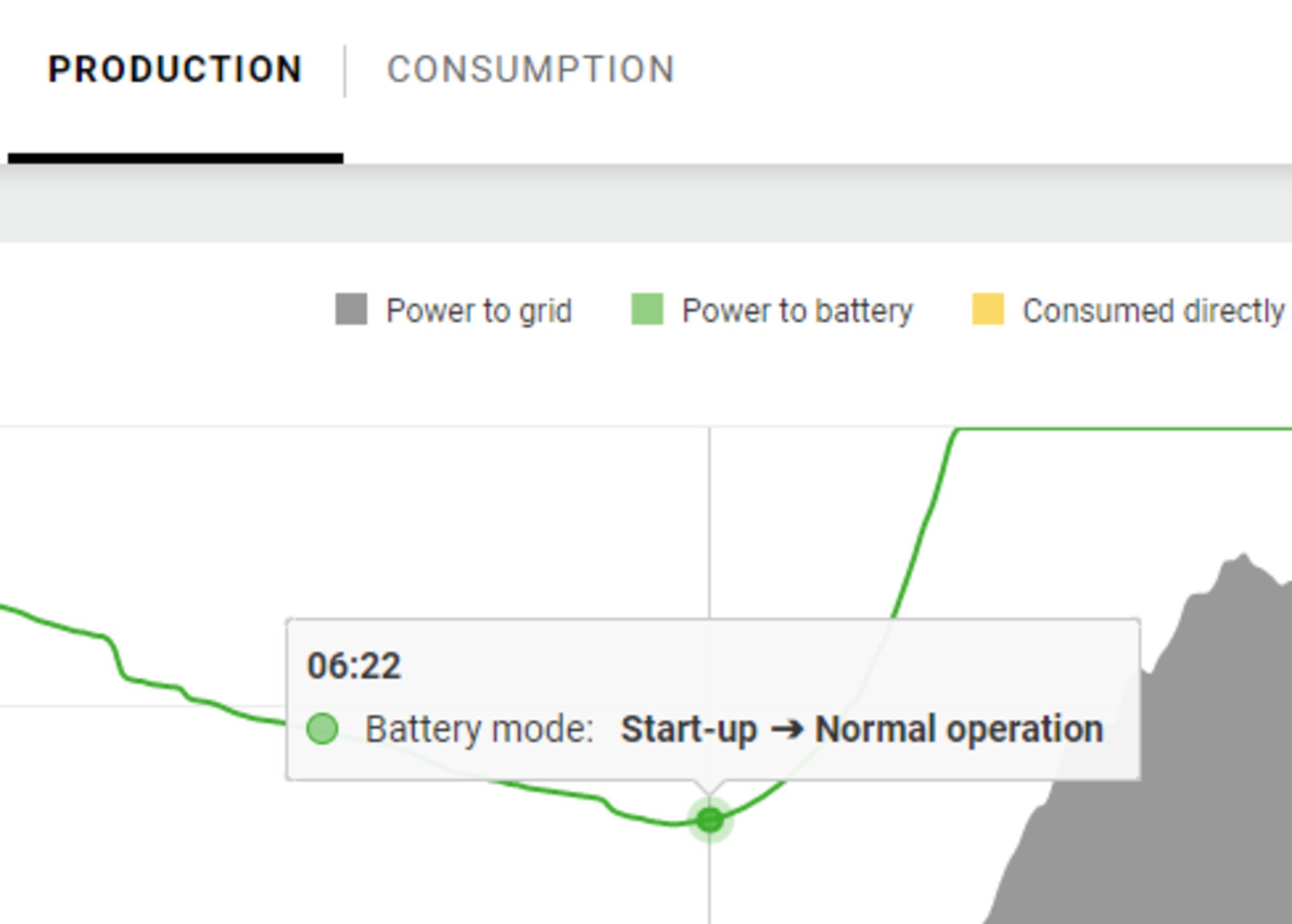

    Register manipulation and Battery status changes in Fronius Solar.web

    Fronius Solar.web allow users to visualize status changes from the battery. These changes can be seen in Fronius Solar.web under the option Energy balance then Production or Consumption. The changes are marked with a bubble status, clicking on a state change will show the previous state followed by an arrow and the new state.
    Battery state change from Start-up to Normal Operation.
    Battery status changes are triggered during normal operation (when the battery is ready to enter in operation, security reasons,etc) or by manipulating the modbus registers MinRsvPct, InWRte, OutWRte and StorCtl_Mod.
    The changes could be triggered as follows:
    • A minimum state of charge is set using the register MinRsvPct, the corresponding state change is “Energy-saving mode”.
    • Setting the registers InWRte, OutWRte, StorCtl_Mod the battery status could change to “Forced Recharge”.
