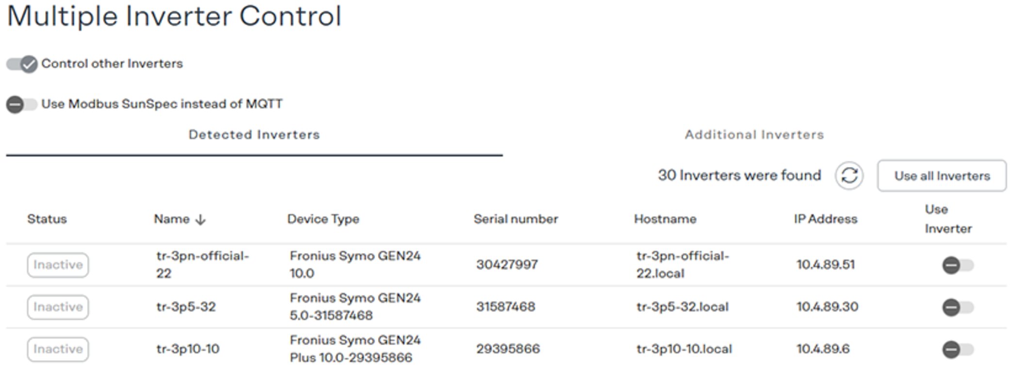

    Dynamic feed-in limitation with multiple inverters
    link_horizontalLink copied
    IMPORTANT! To view and change settings in this menu item, select the user Technician, and enter and confirm the password for the user Technician. Settings in this menu area may only be made by trained and qualified personnel.
    The inverter can be used as a primary device to control dynamic feed-in limits for additional Fronius inverters (secondary devices) so that feed-in limits prescribed by energy companies or utilities can be centrally managed. This control refers to the Soft Limit feed-in limit (see Feed-in limit). The following requirements must be met:
    • Power Control and the Limit multiple inverters (only Soft Limit and I/O Power Management) function are activated and configured on the user interface of the primary device.
    • Primary device and secondary device(s) are physically connected to the same network router via LAN.
    • Inverter Control via Modbus TCP is activated and configured for all secondary devices.
    • The Fronius Smart Meter is configured as a primary meter and connected to the primary device.
    IMPORTANT! Only one primary meter is required for the primary device.
    IMPORTANT! If an inverter with a battery is connected, it must be used as the primary device for dynamic feed-in limits.
    Example connection diagram for dynamic feed-in limitation with multiple inverters
    System limits
    • Systems with a maximum of 20 inverters (1 primary device + 19 secondary devices) are supported.
    • The control is designed for photovoltaic systems with a total output of up to 300 kW.
    • In the case of larger system capacities, the control times in the system are extended.
    • For systems >300 kW, the use of a plant controller is recommended.
    Dynamic feed-in limitation is available with the following device combinations:
    Primary device
    Secondary devices
    Fronius Primo GEN24
    Fronius Primo GEN24, Fronius SnapINverter with Fronius Datamanager 2.0*
    * Up to four additional SnapINverters can be connected to each SnapINverter with Fronius Datamanager 2.0
    Primary meter
    The Fronius Smart Meter acts as the only primary meter and is connected directly to the primary device. The Smart Meter monitors the total output power of all inverters into the grid and passes this information to the primary device via Modbus.
    Primary device
    The feed-in limitation is configured on the user interface of the inverter:
    1In the Safety and Grid Regulations > Export Limitation menu area, activate the Power Control function and select Total Power Limit.
    2Configure the country-specific settings.
    3In the Safety and Grid Regulations > Export Limitation menu area, activate the Limit multiple inverters (only Soft Limit and I/O Power Limit) function.
    The primary device automatically scans the network for available secondary devices. A list of the inverters found is displayed. Click Refresh to perform the search again.
    4Activate Use Inverter against all secondary devices to which an export limitation applies. Click Use all inverters to enable the function for the primary device and all secondary devices.The status of the inverters listed is displayed as follows:
    • Inactive: Secondary device is not configured for the power control.
    • Disconnected: Secondary device is configured, network connection not possible.
    • Connected: Secondary device is configured and accessible via the network of the primary device.
    5In the Safety and Grid Regulations > I/O Power Management menu area, set the controlling priorities as follows:
    1. I/O Power Limit
    2. Export Limitation
    3. Modbus
    Adding an inverter manually
    1Select the Additional inverters menu area.
    2Enter the name, host name, and IP address and the Modbus address of the secondary device.
    3Click Add inverter.
    Secondary device
    A secondary device takes over the export limitation of the primary device. No data are sent to the primary device for the export limitation. The following configurations must be set for the power control:
    User interface secondary device GEN24 / Verto / Tauro
    1Select the user Technician and enter the password for the user Technician.
    2In the Modbus menu area, activate the TCP Server mode and the Allow Control function.
    3For a fail-safe scenario, in the Safety and Grid Regulations > I/O Power Management menu area, set the controlling priorities as follows:
    1. Modbus
    3. I/O Power Limit
    4In the Safety and Grid Regulations > Export Limitation menu area, select and edit the following settings:
    • Activate the Power Control function
    • Select Total Power Limit and specify the total DC power of the entire system in W
    • Enable Export Limit Control (Soft Limit) and enter a value of 0 W for the Maximum grid feed-in power.
    • Enable the Reduce inverter power to 0% if meter connection has been lost function
    1. Settings – User interface of the inverter
    2. Safety and grid requirements
