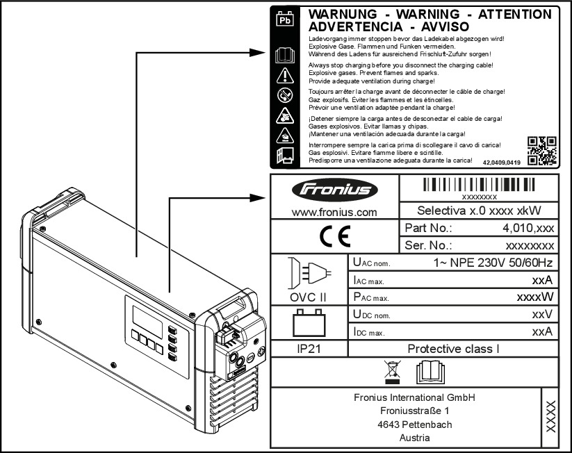

    A number of safety symbols can be seen on the battery charger. The safety symbols must not be removed or painted over.
    Dispose of old devices in accordance with safety rules and not in normal domestic waste.
    Keep potential sources of ignition such as fire, sparks, and open flames away from the battery.
    Danger of explosion! Oxyhydrogen forms in the battery during charging.
    Battery acid is corrosive and must never come into contact with your eyes, skin, or clothing.
    Ensure there is a sufficient supply of fresh air during charging.
    Use functions only after reading the Operating Instructions in full.
