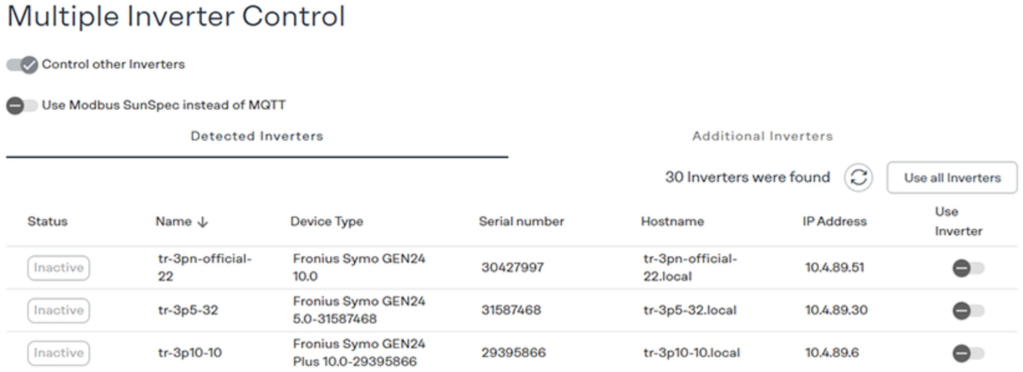

IMPORTANT! To view and change settings in this menu item, select the user Technician, and enter and confirm the password for the user Technician. Settings in this menu area may only be made by trained and qualified personnel.
The inverter can be used as a primary device to control dynamic feed-in limits for additional Fronius inverters (secondary devices) so that feed-in limits prescribed by energy companies or utilities can be centrally managed. This control refers to the Soft Limit feed-in limit (see Feed-in limit). The following requirements must be met:IMPORTANT! Only one primary meter is required for the primary device.
IMPORTANT! If an inverter with a battery is connected, it must be used as the primary device for dynamic feed-in limits.
Dynamic feed-in limitation is available with the following device combinations:
Primary device | Secondary devices |
Fronius Primo GEN24 | Fronius Primo GEN24, Fronius SnapINverter with Fronius Datamanager 2.0* |
Primary meter
The Fronius Smart Meter acts as the only primary meter and is connected directly to the primary device. The Smart Meter monitors the total output power of all inverters into the grid and passes this information to the primary device via Modbus.
Primary device
The primary device automatically scans the network for available secondary devices. A list of the inverters found is displayed. Click Refresh to perform the search again.
Secondary device
A secondary device takes over the export limitation of the primary device. No data are sent to the primary device for the export limitation. The following configurations must be set for the power control:
