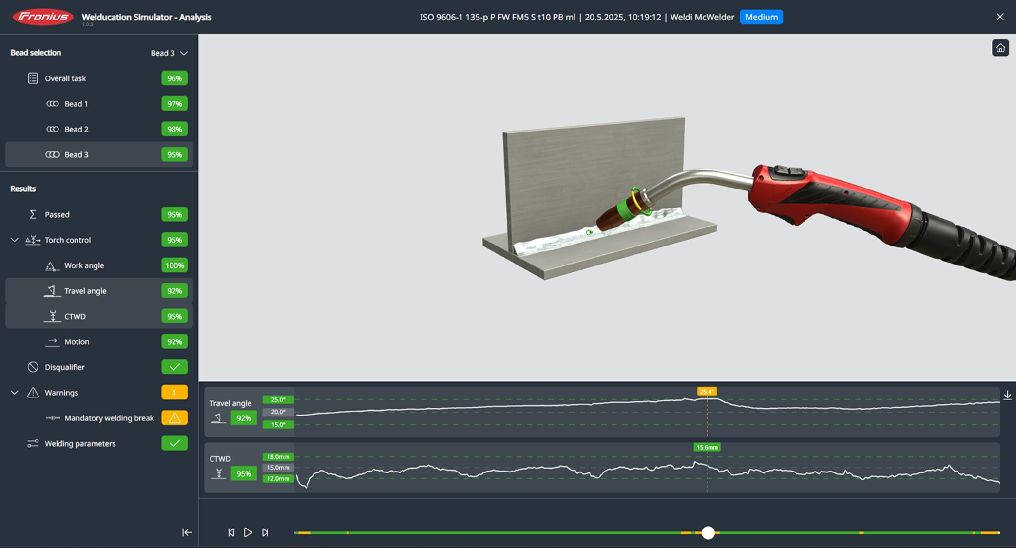

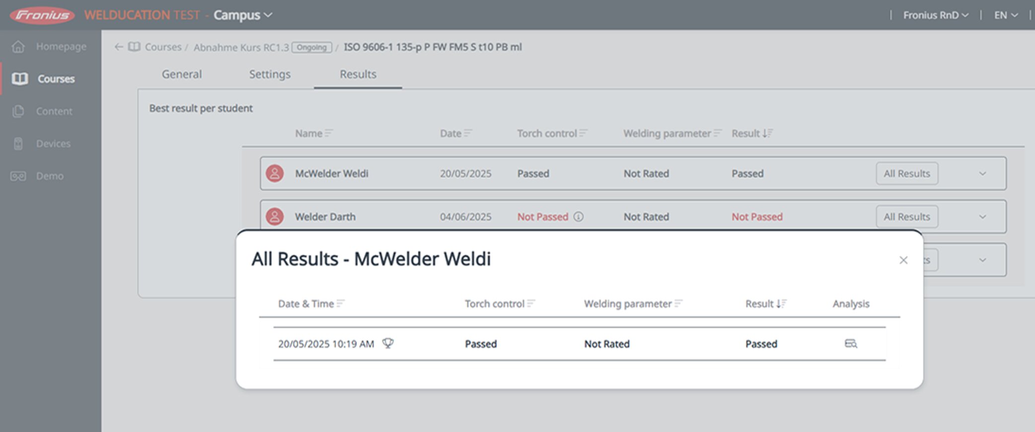

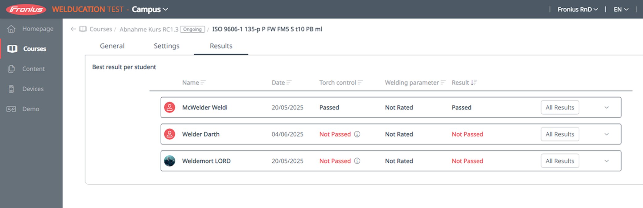

    Evaluating the results
    link_horizontalLink copied
    You also have the option of analyzing the welding result. To do this, proceed as follows:
    1Select the course you wish to view in the "Courses" menu.
    2Go to the "Results" tab to display the designated Campus students for the corresponding task.
    3Select the "All Results" button for the relevant Campus student.
    4For a detailed analysis, select the magnifying glass icon under "Analysis".

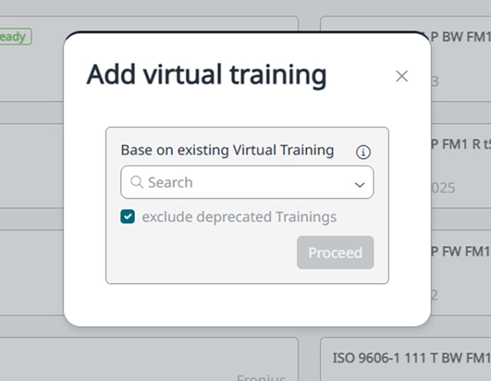

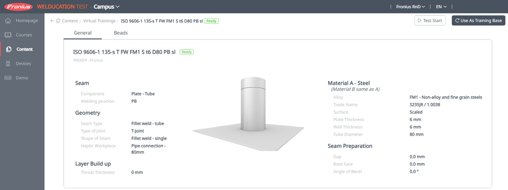

    1Select the "virtual Training" button.
    When selecting virtual training, a detailed description of the respective weld seam profile is provided.
    Virtual welding tasks can be edited, which allows you to modify virtual welding tasks individually. Two options are available:
    Version 1:
    2In the "Add virtual training" dialog window, search for the virtual welding task that you want to modify.
    3Select the "Proceed" button.
    4Select the "Use As Training Base" button in the dialog window that opens.
    Version 2:
    2Use the filter and search function to set the criteria and use them as a training template.

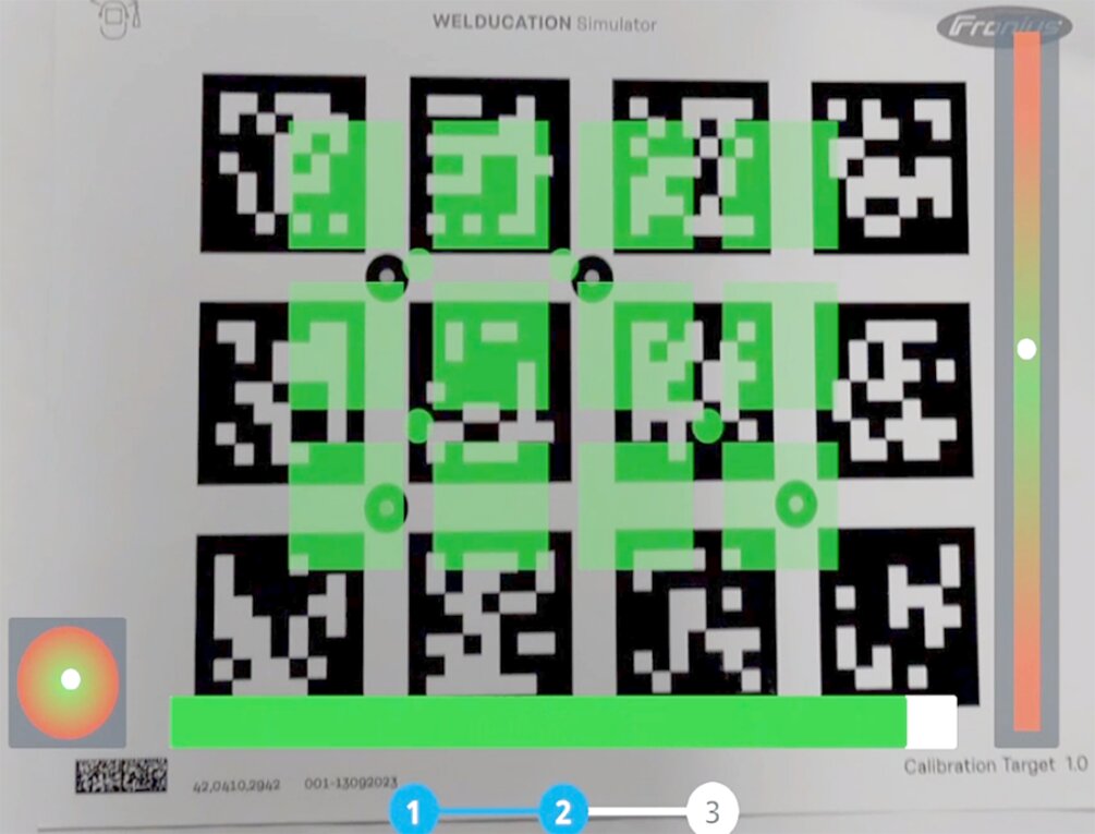

    Calibration is initiated by the trainer. Once the calibration has been initiated by the trainer, the calibration prompt only appears when a welding job is restarted.
    Carry out the calibration using the provided calibration target, as follows:
    1In the "Devices" menu, click on the icon with the three dots to activate the XR headset calibration for the respective Welducation Simulator.
    2Start a virtual task with the respective Welducation Simulator.
    3Remove the calibration target from the protective film and place it on a flat surface.
    4Aim the XR headset at the calibration target.
    5Activate calibration using the "Start calibration" button.
    6Follow the instructions for optimal alignment:
    • Circle on the left:Angle control
    • Bar on the right:Distance control
    As soon as the superimposed overlay turns green, calibration starts automatically.
    7Keep the position steady until the progress bar indicates the process has been completed.
    • The calibration is repeated for a second distance (greater distance).
    8Check whether the workpiece is displayed correctly in the virtual space:
    • Calibration OK: "Save"
    • Calibration inaccurate: "Repeat"
    Once calibration is complete, the virtual welding task can be performed as usual.
